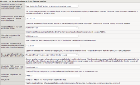

Hi Joe, a few questions for you:
1) I assume that this is a 2 BIG-IP setup, that is, you are forwarding reverse proxy traffic from this external BIG-IP to a virtual server on an internal BIG-IP. Correct?
2) If 1 is true, then 172.21.x.x is the internal Front End virtual server listening on port 4443?
3) The iApp creates an iRule that only passes traffic for the host names that you enter in the Front End FQDN, Lync Mobility FQDN, and simple URLs fields. I see that you are using lyncdiscover.x.x for your Front End server pool FQDN, but usually that name is reserved for Lync mobile use. Is that the correct pool FQDN? You are trying to access the external VIP using an IP address, but that will not work because the iRule will not pass the traffic.
Have you checked out the deployment guide for the iApp: https://www.f5.com/pdf/deployment-guides/microsoft-lync-iapp-dg.pdf? It has more detailed information about the iApp and also some post-config steps that may be required, depending on your topology.
thanks
Mike
- Joe_8700Jun 10, 2014
Hi Mike, Thanks for the inputs, 1) We have only 1 BIGIP which we use for port forwarding. From the public IP 203.177.x.x traffic is forwarded to the REAL IP 172.21.x.x of the front end server with port 4443 3) I have remove the iRule which seems to be the reason why I cant connect, now full traffic is being forwarded and when I simulate browsing using internal and external IP result is now the same. Thanks for the inputs again, I just dont know if Lync mobile is now working, I just hope the problem is no longer on my side but theirs. Joe - mikeshimkus_111Jun 11, 2014Historic F5 AccountPage 21 of the guide covers how to deploy a single BIG-IP for reverse proxy, FYI.
