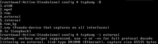

      • I think that practically every article on that matter will mention that you should be careful when you run tcpdump on a busy box. I don't know whether your box is busy or not, but here are some hints.
        You can run tcpdump -D. This will output a list of all available interfaces. You could use the corresponding interface from the list, instead of using 0.0. Example:
        Also you should filter as precisely as possible and combine filters. In the following example I filter for host IP and port.
        Also in this example I use tcpdump -n to disable name resolution of host names. Example:
        tcpdump -ni external host 10.100.200.50 and port 80
