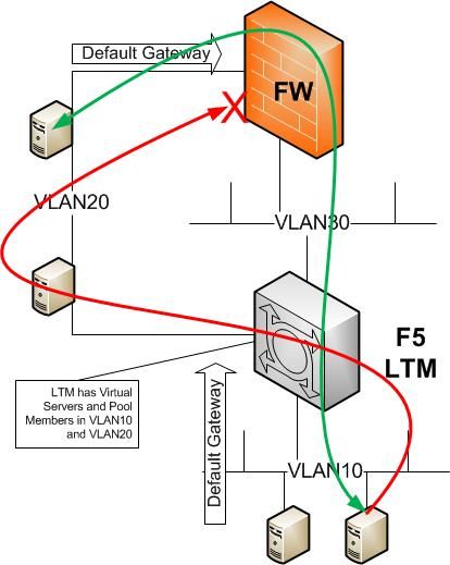

I have a scenario in which my LTM is the default gateway for all hosts on VLAN10. The LTM also has a directly connected interface in VLAN20. However, hosts in VLAN20 do not use the LTM as the gateway...

I wonder why using Last Hop Pool (with pool containing firewall from VLAN 30) configured on Forwarding IP VS will not work? After reading plenty of docs it looks for me that this method can be used to override any routes, so should as well override entries for directly attached networks. Am I wrong?
Well, I have to be wrong, after some test I am pretty sure that LHP can only be used for returning traffic not original traffic, sorry for messing around.
