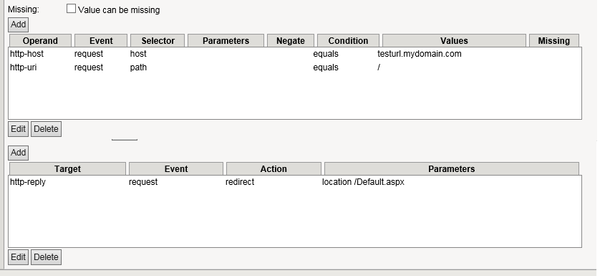

Hello all,
I was wondering if anyone could help me with my issue.
I use LTM policies to redirect URL to the correct pools etc.
I have few policies configured on F5 running firmware v11 and it works perfectly fine:
When end user types in a URL for example: testurl.mydomain.com the policy will add additional piece to the URI and redirect the request to a appropriate pool.
I have achieved this by configuring 2x separate rules:
1st rule will check the HTTP-HOST is equal to testurl.mydomain.com and HTTP-URI is equal to / If it is, it will do HTTP-REPLY and redirect to /Default.aspx
The aim is to make the URL user friendly so the end user will only type testurl.mydomain.com and /Default.aspx will be added by the policy testurl.mydomain.com/Default.aspx
2nd rule will check the HTTP-HOST again and if it is equal to testurl.mydomain.com it will redirect the request to the pool.
As I have said, it works perfectly fine. The challenge I am facing is that I can't get this working on LTM running firmware v13, it looks like HTTP-REPLY option isn't there anymore.
Any ideas?
I don't want to use iRules, needs to be a policy.
Rule1 on v11 (works fine):
