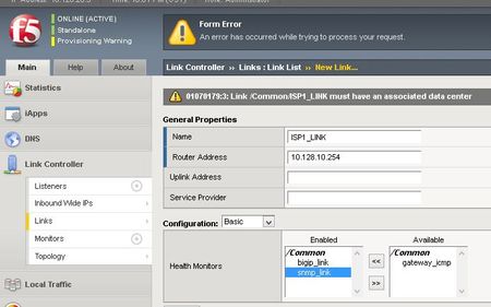

Link Controller v12.1 Link Creation error. no reply from big3d
Hello,Thank you. My device is not in USA, so in theory i should be eligible to apply the sol. I am working with the solution you refer, but my pool and wideIp does not work with any load balanced method beside round robin, so this SOL does not apply. In any case, i did apply the workaround explained there, but still the same result.
Strange. I've tried to reproduce this in my lab but the gtm pool members show green. Perhaps I've not set it up the same way as you have, or my license is slightly different.
Can you provide your gtm (lc) configuration ?
Alternatively, open a support case, so that we can take a proper look at the qkview and license details.
