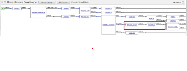

Michael, i think we got past the pop up thing. Its strange that once the reverse DNS lookup entry was added it took care of the delay and also the popup. Now we are seeing something different. Most of the times the seamless thing is working but once in a while we get a page cannot be displayed. We put some message boxes in place and see that the below highlighted path is taken and it just fails with a "page cannot be displyed" message in the browser. When we took the packet captures we see that there is a ack,rst from server and nothing happens. On the apm logs we see that "session is deleted due to user inactivity". Is there something else we are missing?
- Michael__

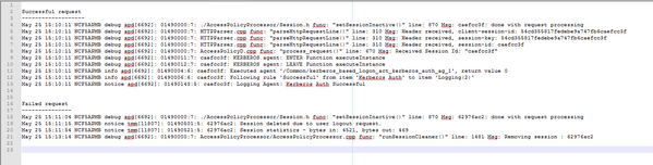

Hi, the PTR entry for the SPN is mandatory or at least a host entry (on the APM) to get the Kerberos auth with the F5 working About the RST Could you set the Access Policy Logging to Debug (System ›› Logs : Configuration : Options) and check the log output (/var/log/apm) for a reason ?!
- f5learn_164388
Thanks, Michael. Please find the screenshot below which has the last few lines from debug logs for successful vs failed logins.
