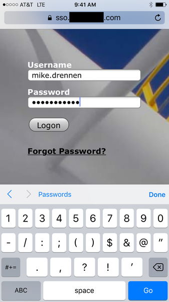

Mar 14, 2016Issue with Mobile devices using APM. Getting "Connection Reset / Lost"
I am experiencing an issue with accessing our APM with a mobile device. Initially, I thought it was only on Apple products but have since been able to recreate it on Android consistently. What happ...
