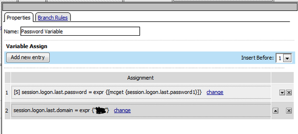

  • This is what the Password Variable object has in it:
    Basically it is reassigning the password variable from the password1 variable passed from the login form.
    One thing to note is that the iApp template doesn't assign the variable as secure. You may need to go in and do that as well.
