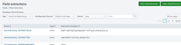

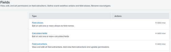

  • Hi Forme_Newbie,
    To configure F5 LTM field extraction settings in your Splunk data source, In Splunk ,navigate to Settings > Fields > Field extractions within the Splunk interface, where you can define custom extraction rules using regular expressions to identify and isolate specific data fields from your F5 LTM logs, allowing you to analyze them individually within Splunk searches and reports.
    Key points about F5 LTM field extraction in Splunk:
    Splunk Add-on for F5 BIG-IP:
    To effectively extract F5 LTM data, utilize the dedicated Splunk add-on for F5 BIG-IP which provides pre-configured field extractions tailored to F5 log formats.
    Props.conf and Inputs.conf:
    These configuration files within your Splunk environment are used to define how raw F5 LTM data is parsed and mapped to specific fields.
    Field extraction methods:
    Automatic extraction: The Splunk add-on might automatically identify common fields based on the log format
    Regular expressions (regex): For complex parsing scenarios, use custom regex patterns to extract specific data from the log lines.
    Important fields to extract:
    Virtual Server Name
    Client IP Address
    Pool Name
    HTTP Status Code
    Transaction Time
    Application Name
    How to configure field extraction:
    1. Access Field Extractor:
    Go to Settings > Fields > Field extractions in Splunk
    2. Select sample data:
    Choose a sample log entry from your F5 LTM data source to test your extraction rules.
    3. Define extraction rules:
    Field names: Specify the names you want to assign to the extracted data fields.
    Extraction method: Select "Regex" and provide the appropriate regular expression to match the desired data within the log line.
    4. Validate and save:
    Review the extracted fields to ensure accuracy and save your configuration.
