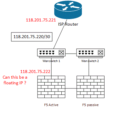

Is static self-IP necessary for WAN connection in a cluster setup ?

If you want to go with what is on the network diagram - you do need a local-only SelfIP on each unit. It's a pre-requisite to configure Floating SelfIP. BUT there's no significance for device operation if you populate these local-only SelfIPs with IP addresses that your ISP will not route in the Internet for you. So you can populate your BigIP 01 local-only SelfIP with 118.201.75.217/29 and BigIP 02 local-only SelfIP with 118.201.75.218/29. Confirm this wish with your ISP.

The segment right now between the ISP and F5 is a /30 network namely 118.201.75.221 and 118.201.75.222
I understand I will need to create a static self-ip before creating a floating one.
Can I somehow "trick" F5 by creating a static self-ip .e.g 118.201.75.220/29 but in actual fact this IP/29 was not assigned by the ISP to us. (we are only allocated a /30)
Since the ISP is routing to us using the .222/30 IP as its next hop, and i have configured .222 as a floating IP, communication from and to device will use .222/30 IP which is valid.
Will there be any implication then since the "fake" static self-ip (118.201.75.220/29 in this case) is never actually in use ?
