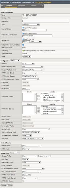

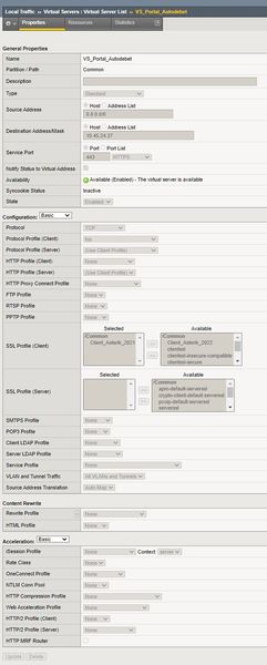

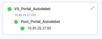

I have 2 VS in serverfarm and DMZ. The pool member SVF is used by IP VS DMZ.
SVF (port custom 45112)
DMZ (port 443, using SSL)

      Here the configuration:
      VS SVF : SNAT_to_192.168.12.220, http profile: http
      VS DMZ : SNAT automap, client SSL Asterisk

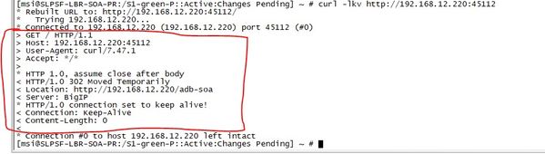

      I tried to curl the VS and pool member :
      The result same and have been redirect corectly right ? ..

          HTTP::redirect "http://192.168.12.220:45112/adb-soa"
        so if i using this irules, the web browser pages display "the page is not working", but the irules redirect works when i hit http://192.168.12.220:45112. Its redirect to http://192.168.12.220:45112/adb-soa

    1.      First check application status using actual application server on required port. In your case, it will be – http://10.45.26.37/adb-soa and see if it gives you required page. This testing needs to be done from any LAN system which can reach this server. If this is working then go to next step. Otherwise need to work on application side to see if application is configured properly.

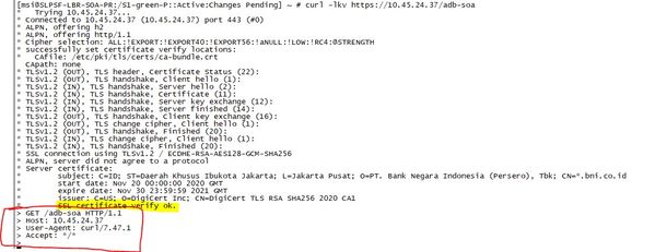

    2.     Now check application status using https://10.45.24.37/adb-soa to see if app is loading properly using DMZ VS.
