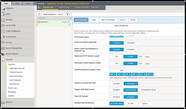

But if you want that your irule match with ASM you have to appll a configuration .
In your asm policy, you have to enable “Trigger ASM Irule Events” as display below in your ASM Policy:
Keep me in touch.
regards.
- elox1992
Hi youssef, thanks for your answer. Trigger ASM iRule event is enabled(normal mode). Otherwise the asm:unblock would not have worked on the URL if I´m not wrong. Strange thing is that iRule also matched on the datagroup as I could verify that in the logs but the unblock somehow did not work. I also checked if attack signatures or other violations have been triggered with the upload but only "VIOLATION_REQUEST_TOO_LONG" was triggered and log showed that asm:unblock was done. However, customer reported upload was blocked. If the iRule is correct my guess is that it that something went wrong on customer side since I saw two requests withing a few seconds from the customer who said he did only one upload. I will be able to test it again tomorrow and ask customer to do upload via a browser and not with curl.
