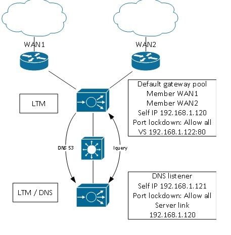

To explain the issue in more detail I included some more pics and graphs. This is the lab architecture both F5 Big IP VMs are located in the same network segment.
The external LTM has connectivity to both internet connections. The internal LTM / GTM combo needs to resolve DNS requests and know the link status of both Links and virtual servers. So I was thinking to integrate the internal GTM with the external LTM using Iquery.

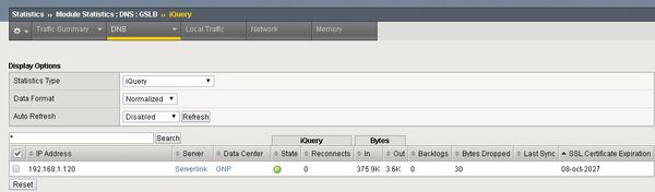

The server link is active configured on the internal GTM using the external Self IP 192.168.1.120 and Iquery traffic is flowing between both F5 devices.

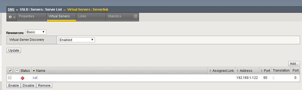

So that seems to work properly, but the thing is that the internal GTM is unable to determine the status of links and virtual servers nor discover them automatically. If I configure one manually its becomes unavailable.
But the virtual server is indeed available on the external LTM.

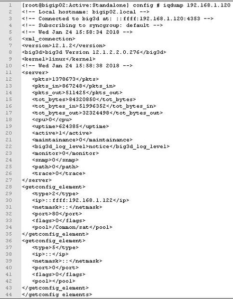

Analyzing the Iquery traffic using Iqdump I do see active traffic.
Someone any idea what to do to solve this issue?

In this lab environment I dont have WAN links, but the idea is indeed to have two WAN links connected and publish the Wide IP using two public IP addresses. I understand the logic and have implemented it several times. The only thing is that I ran into this technical issue using an internal DNS integrated with an external LTM that currently is not able to verify the status of the virtual servers configured and active on the external LTM device. The server link is green as you can see above but it does not discover any of the virtual servers of the external LTM nor the status of the virtual servers.
Maybe perhaps this is just a small issue using VMware I really dont understand, but I understand correctly this setup should work accordingly.

In this setup it is a bit different because we are using to different F5 devices (Internal DNS and External LTM)
Is it possible to have this, refer to the design above:
Big IP LTM external, that means no Link Controller only LTM with default pool gateway in a separate VLAN
Big IP DNS internal, Link discovered via server link from the external LTM device, is that possible or not supported?
- Marvin
Cirrocumulus
I know yes and have experienced this behavior that when implementing a DNS+LTM combo when having defined the GTM links with bigip_link monitor and not defined in the LTM gateway pool the links wont come up. So it seems that both of them needs to work together, so I am questioning if it is even possible to seperate LTM and GTM on different F5 devices and having the LTM externally on other words the F5 DNS will not have direct connectivity to the gateways, it can only fetch the link status via the external F5 LTM device.
Hope it makes more sense now. I know its a little weird architecture but at this moment I dont have other options to implement this.
