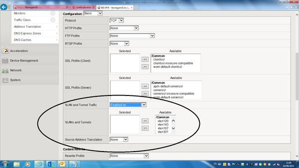

I should be able to define Vlan and SNAT pool options when I create Virtual servers using iApps , but not able to do that. - cjunior

I should get the following options. Also please upload the codeshare in .txt format as I am unable to open .tmpl format . You can share just the particular part of the codeshare.
