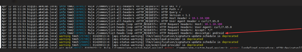

I am adding a custom http header but how to print it out using irules?

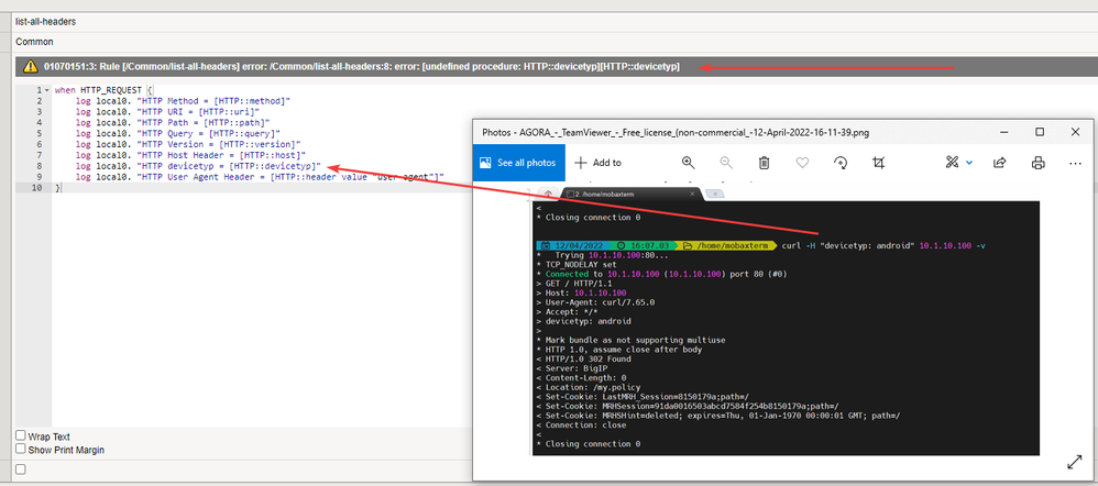

Here's what I have done using curl -
The curl request is seen with "-v" it shows that the devicetyp header is being added to the request, but how do i fetch it from irules?
I can see the header if i use this irule with a loop:
when HTTP_REQUEST {
foreach aHeader [HTTP::header names] {
log local0. "HTTP Request Headers: $aHeader: [HTTP::header value $aHeader]"
I want to grab this header value and store in a customer apm variable like session.custom.device.type.. i understand there are other ways to do this but we have chosen this for now.. any ideas??
  • David_M's avatar
    David_M
    Apr 15, 2022
    that didnt work but this did
    when ACCESS_SESSION_STARTED {
    ACCESS::session data set session.custom.devicetype [HTTP::header value devicetyp]
2 Replies
  • Hello David_M.
    You should get the header value with this command:
    [HTTP::header value "devicetyp"]
    Also, you can set the APM session variable with:
    ACCESS::session data set session.custom.device.type [HTTP::header value "devicetyp"]
    • David_M's avatar
      David_M
