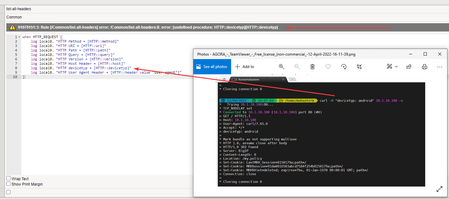

Apr 12, 2022I am adding a custom http header but how to print it out using irules?
Here's what I have done using curl - The curl request is seen with "-v" it shows that the devicetyp header is being added to the request, but how do i fetch it from irules? I can see the he...
- Apr 15, 2022
that didnt work but this did
when ACCESS_SESSION_STARTED {
ACCESS::session data set session.custom.devicetype [HTTP::header value devicetyp]

Apr 13, 2022Hello David_M.
You should get the header value with this command:
[HTTP::header value "devicetyp"]
Also, you can set the APM session variable with:
ACCESS::session data set session.custom.device.type [HTTP::header value "devicetyp"]
- David_MApr 15, 2022
Cirrostratus
