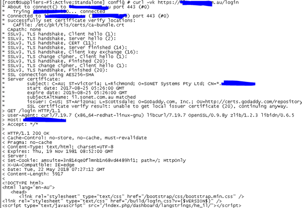

when troubleshooting this issue from cli:
[root@Cust-F5:Active:Standalone] config openssl s_client -connect 172.26.133.213:443 -state
CONNECTED(00000003)
SSL_connect:before/connect initialization
SSL_connect:SSLv2/v3 write client hello A
SSL_connect:error in SSLv2/v3 read server hello A
write:errno=104

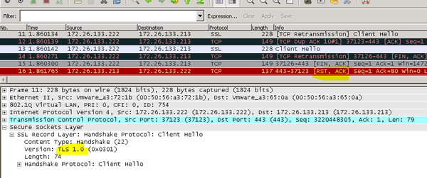

Probably bigd is using TLS1.0, while the server is expecting TLS1.1 or TLS1.2.
Just take a tcpdump, and check what error you get via bigd.
tcpdump solution:
https://support.f5.com/csp/article/K411

So it is clearly SSL/TLS version mismatch issue. Can you run a tcpdump with below syntax tcpdump -vvv -s0 -nni 0.0:nnn host internal static self ip or host pool member ip address -w /var/tmp/
_`date +%Y-%m-%d--%H%m%S`.pcap./bin/hostnameSame time do enable SSL debug to confirm the same. Troubleshooting SSL/TLS handshake failures : https://support.f5.com/csp/article/K15292enable

, according to K16526: Configuring the SSL cipher strength for a custom HTTPS health monitor.You cannot modify the TLS/SSL protocol version. The HTTPS monitor will choose the highest level TLS/SSL protocoIt is more likely that your back-end server does not accept higher versions of SSL/TLS protocol. You can check the supported version of that server by running the following on BIG-IP:
openssl s_client -tls1 -connect x.x.x.x:443You can also use other flags when checking:
to find out exactly what is supported there.-ssl2, -ssl3, -tls1, -tls1_1, -tls1_2, -no_ssl2, -no_ssl3, -no_tls1, -no_tls1_1, -no_tls1_2 - Anoop_Jayadharan
