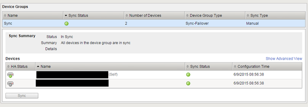

Hello,
I'm trying to get the device groups status.
The API GET query seems to be https://172.17.170.11/mgmt/cm/????.
After reading the TMSH documentations and APIREST documentations I didn't found the solution.
Somebody can help me please?
Best regards
4 Replies
- amolari
Cirrostratus
try this:
curl -k -u https:///mgmt/tm/cm/device-group/~Common~/stats
- JulienDebbia_20
Hello,
Thank you to help me.
I tried it but it doesn't work.
Best regards
- JulienDebbia_20
Ok it works now, I forgot the "/tm/" in the URL.
Thx
- lhoge_191942
I found that this worked for me on 12.0
Method - Get https:///mgmt/tm/cm/sync-status
This should provide your device group status.
