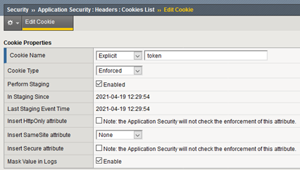

  • Hi Wasfi,
    you could mask the cookie value in the logs. The process is described in K52154401.
    It should look similar to this:
    KR
    Daniel
4 Replies
  • Hi Wasfi,
    KR
    Daniel
  • Thank you Daniel. Although my intention is not to log the Cookie due to its length, not due to its private content. It is consuming most of the log message.
    Would masking it reduce its length too?
