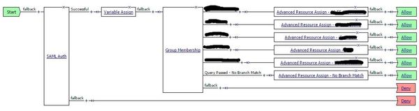

I have created a new webtop for use by a seperate group. This access profile uses SAML authentication that hits our corporate ADFS. Here is what my Access Policy looks like right now:

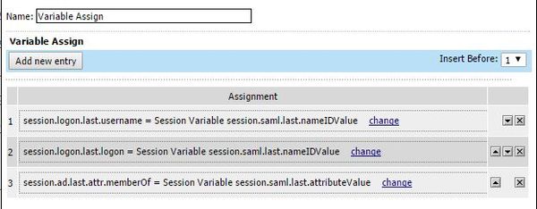

The Variable Assign looks like this:
The last one on the list is the one the I know I don't have correct. As part of the SAML assertion that is coming back from the IdP is the list of groups the user is a member of in AD. It comes back in the assertion as :

I want to either take the group in and turn it into the variable session.blah.blah.memberOf so that I can consume it as an AD group in my Group Membership box so that it can pass the user to the correct Advanced Resource Assign box so the users sees the correct webtop link.

I'm not sure I made this clear, but I'm trying to get the AD groups from the Saml assertion to be assigned to the variable of session.ad.last.attr.memberOf so that resource assignments can be made based on the User is a member of expression.

you need to use tcl expression your variable assign to reformat the output. when doing an AD query memberOf attribute looks like :
, replace pipe by the pipe symbole.group1 pipe group3 pipe group3here is some examples of tcl syntax when you extract subect name from ssl certificate : https://support.f5.com/kb/en-us/products/big-ip_apm/manuals/product/apm-config-11-4-0/apm_config_advanced_policies.html
