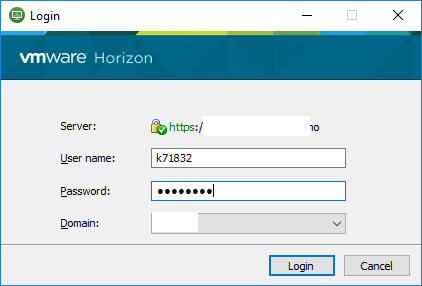

AD login works fine:

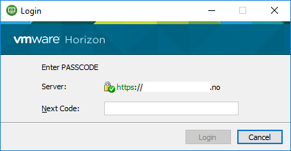

First prompt for radius authentication:

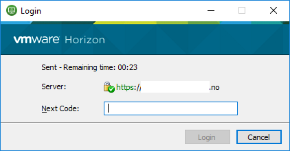

Second prompt for radius authentication opens up regardless of whether the password in the first attempt was correct or not:
