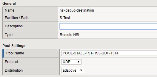

I am trying to get some values from a HTTP header to be sent to a SumoLogic Collector and am having difficulties with how the messages end up at the SumoLogic box.
I can see the data being sent to the SumoLogic box but it doesn't seem to be able to read it. The log is just random corrupted text.
I have setup a Log destination as Remote HSL using a pool UDP/1514 and the Publisher set to the Destination config

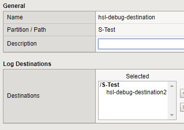

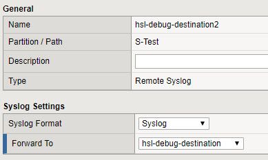

I have also tried setting up another destination using remote syslog and forward that to the Remote HSL Destination as well but still get same result.
I know this is being sent to the SumoLogic collector because I have got captures going out to the Sumo collector and the UDP Packets contain the text I wanted logged.
Is there some issue on the F5 or is the Sumo collector not reading the format right or something??.
Cheers
