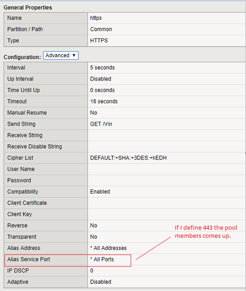

I have an HA F5, active and standby unit. I created 1 VS and the pool health monitor uses https profile with default settings, see attached image for the health monitor settings.
The results where.
In active unit the pool is down, the health monitor it uses tlsv1 to communicate with the server causing a fatal error protocol version
If I define the port 443 instead of using * All Ports, the pool comes up.

What I dont understand is why on .12 the ltm is negotiating using tls1 while in .11 is tls1.2.
In .12 the pool is down while in .11 the pool is up.
I did openssl on both using the default cipher list on the health monitor profile and the ltm by right is not supposed to use tls1 as there is no tls1 in the list.
- Remove the https monitor from pool , save the config and add back same monitor in pool
- I did this already. The only fix is to define the port 443 instead of using * All Ports.
