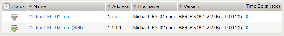

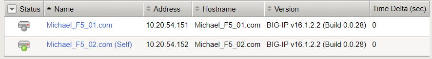

I have two devices in HA status and they are as follows
Then for some reason I had to delete mgmt_IP, but after that, the HA status became strange as follows
And there is no way to do active/standby conversion...
I found that I had to let one device have mgmt_ip so that the state could be restored
What is the mechanism that causes these situations?
Any help is appreciate.

      Original : Michael_01 (standby/have mgmt_ip) / Michael_02 (active/none mgmt_ip)
      17:41:17 -- delete Michael_01 mgmt_ip
      17:42:58 -- Michael_02 want to change to standby
      I checked it out and came up with the following log:
      Michael_01:
      Michael_02:
