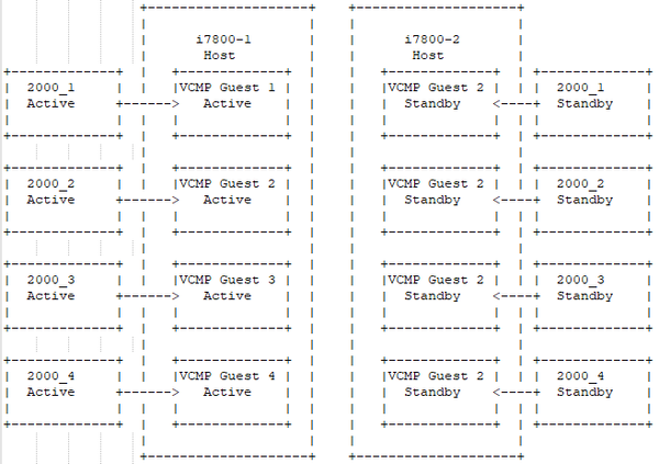

    K15496: Migrating a device group member to a new BIG-IP hardware platform
    ∟ This article might help with questions related to your concept.
    Generally speaking this is how the devices should map to each other:

    I will try to use your figure to explain my request:
    I need to run "2000_1 Standby" into a Guest intothe same hw i7800-a : to do that do i need to configure 2 VCMP HOSTS into the i7800-a ? (so "2000_1 "Active will run into vCMP HOST 1 into i7800-a and "2000_1 Standby" will run into vCMP HOST2 into i7800-a ?
    or i don't need to do that so the 2 Guests ( "2000_1 Active" and "2000_1 Standby could run in the same vCMP HOST (into 7800-a) ?

  • Do not put both your Active and Standby devices on the same VCMP host, this negates redundancy if the host has problems or goes hard down you lose both active and standby resulting in a site down
    You need two i7800s, i7800-a and i7800-b. All Active VCMP guests (2000_1 Active) will go on i7800-a, all standby guests will go on i7800-b.
    If that isn't an option then you will simply not configure HA and have all standalone guests on i7800-a with no redundancy.
