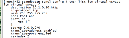

Hi I made configuration on one(6) of two F5. When I sync from the F5-6 to F5-2 (chose Snyc device to group), I got error message which show the sync unsuccessful. Please see the picture. Any one can ...

Oct 10, 2016Thank you for your reply. Now I just found the Snyc can work in my F5 after any change of configuration except creating Cert. I do not know how to solve the issue

So if you export the Certificate and Key that you recently created / uploaded, then delete them, then sync the devices, the sync completes successfully?
If so, if you import the key then the certificate back into your system and attempt the sync again, is it successful?
