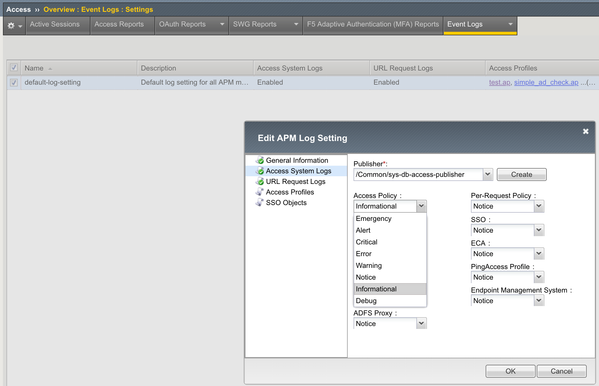

Some agents do nice logging so following the flow is easy, like this:
Following rule 'fallback' from item 'VPN_compliant_check' to ending 'Deny'
However, not all agents seem to do this logging. For example AD auth and client OS check does not seem to do this. So I sometimes end up tshooting stuff for customers where maybe 8-9 agents are involved, jumping in and out of macros, between two rows in the log file. I know there is a Logging Agent you can use, but that means deploying hundreds of them, it's not really doable.
Can you configure APM to log all the branches chosen for every agent? Also, is there any simple rule for which agents do this logging?

  • ecce's avatar
    ecce
    ... ofcourse I found the answer to this a few seconds after posting. Setting the Log Level to informational (default: Notice) shows branches chosen for all agents (the ones I've tested so far at least).
