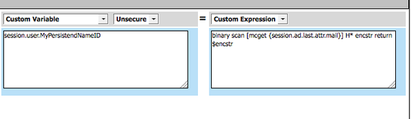

I use the following:
The APM log shows the following error "Rule evaluation failed with error: can't read "encstr": no such variable". The variable is not visible at all.

make sure you have a line break between the "encstr" and the "return"

As for the VPE assignment, you need a semicolon between the commands:
binary scan [mcget session.ad.last.attr.sAMAccountName] H* encstr; return $encstr - ChristianH_1903
Dear All, adding the ";" did do the trick.
