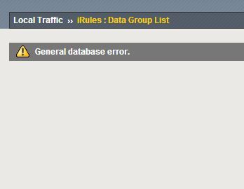

"General database error" when adding an entry to a Data Group List
Hi,
I have the error message "General database error"when adding an entry to a string Data Group List:
For instance, when adding www.test.com in the following Data Group List:
And Update:
I have tried to create a new Data Group List: It's the same problem. The first creation is well done but updates failed.
In the LTM log, there is nothing when the "General database error" appears, but i have this message which appears every 5 minutes:
    Nov  6 16:33:28 vilbf5 err mcpd[6532]: 01071704:3: Not running command (/usr/libexec/localdb_mysql_restore.sh) because the request came from an untrusted connection.
    Nov  6 16:38:28 vilbf5 err mcpd[6532]: 01071704:3: Not running command (/usr/libexec/localdb_mysql_restore.sh) because the request came from an untrusted connection.
    Nov  6 16:43:28 vilbf5 err mcpd[6532]: 01071704:3: Not running command (/usr/libexec/localdb_mysql_restore.sh) because the request came from an untrusted connection.
I don't know if this message is related to my problem? I'm running version 11.4.1. I have also tried to restart the BigIP, but there is no change. Thanks for your help!

  • I believe in v11.4 that every string must have a value, hence your issue. I think a blank space will suffice but you may need to recreate them to add that, or use tmsh instead.
  • please see :
    http://support.f5.com/kb/en-us/solutions/public/14000/600/sol14671.html
    • vmunier_96939's avatar
      vmunier_96939
      Thank you, it's exactly my problem. It's ok with using the tmsh utility to update the affected data group.
