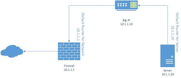

FORWARDING Virtual Server in the same Network with default Router
I have the following situation, the F5 cluster, the servers and the default router are in the same network. Now the requirement is that the servers should see the original Sorce IP. Since the servers also have to communicate so outward, I have built a forwarding VS on the F5. My idea behind it was that the servers should use the F5 as Deafult router and the F5 forwards the packets further to the default router in the network. Unfortunately, I do not see that the F5 forwards the packets to the Deafut router. Does anyone have an idea what this could be? Which IP of the F5 need the servers as default router? The Floating IP?
