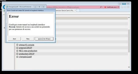

Jun 15, 2016FirePass:could not create tunnel on loopback interface
There is a top-pop error "could not create tunnel on loopback interface" when the remote citrix VDI client try to connect the static application tunnel.
FirePass Version:6.0.1
what happened and ...

Hi Demeter~ I'm pretty sure this is your issue:
SOL8616: Portal Access fails to open ICA connection when browsing Citrix portal - https://support.f5.com/kb/en-us/solutions/public/8000/600/sol8616.html?sr=55080894
Says fixed in 6.0.3 but you can also grab the hotfix for 6.0.1 from our downloads site. downloads.f5.com
