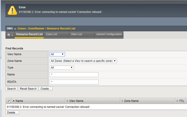

find cause for the issue : 01150306:3: Error connecting to named socket 'Connection refused'.
Customer has a big-ip DNS setup on Viprion. We faced the below error in Configuration Utility.
It is running version 15.0.1. I am unable to trace any information related to error : 01150306 (mentioned below)
DNS>> Zones::ZoneRunner : Resource Record List
Apr 14 10:11:12 slot1/bigipDNS err zrd[2747]: 01150306:3: Error connecting to named socket 'Connection refused'.

  • There are no qkview logs which can tell what went wrong with the bind.
    The possible issue seems with the named service
    Debug log for zrd and bind needs to be captured if the event occurs frequently to identify the possible reason behind this error.
    Below article for capturing zrd and bind logs:
    https://support.f5.com/csp/article/K14680
    The workaround will be to restart the 'named' and 'zrd'.
