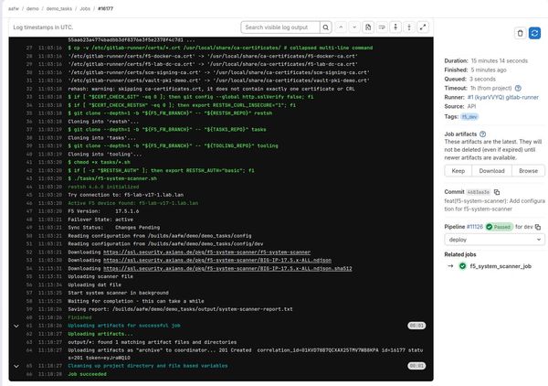

Installing the tool manually on a fleet of F5s and running the scans by hand is not my operating modal.
I implemented a Restsh function f5.system-scanner that does the heavy lifting for me in an automatable way. It uploads the f5-system-scanner binary and the dat file with the hashes to the F5. Runs the f5-system-scanner in the background and downloads the report after it finishes it. The script exits with an error code if the scanner found a hash mismatch. This is the ideal basis to put it in a pipeline and deploy it at scale.
