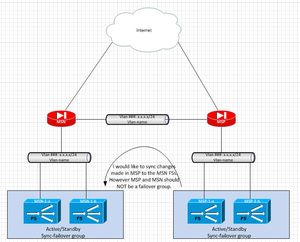

I am looking for some help on F5 sync’ing options. I have opened an F5 support ticket with the below opening notes. However I thought I would reach out to the this forum as well. I wonder if this ...

We have the same problem, we have a production site in Miami, and our DR in Brasil. I have tried to setting up the trust domain with more than 2 units, but every time that we add the third we lost the trust relation between the first two. Did you get the solution to this problem? Please, what must we do? Thanks

Hi Stephan, We are trying to setup a sync-failover of four members, two in Miami that is the production environment, and two en Brasil that is the DR site. I have the same problem than Aaron, we can sync the two devices in both sites, but when we tried two create a trust domain of four devices we ran into problem. We have a sync network in both sites that is routed on MPLS, is not a connectivity problem. Once we add the third device to the trust domain, we lost the relation that we already have with the second member. Thanks
