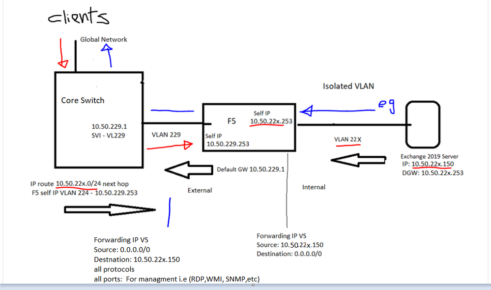

I'm going to try both methods and reply back for closing the thread. One last question, for the option 1, where the isolated subnet is only routable through the F5. I'm assuming we need to create another IP forwarding VS for the management traffic i.e RDP, SNMP, WMI, etc to monitor and managed the server correct? So there will be one IP forwarding VS for server initiated traffic and another IP forwarding VS for inbound communications to the server, as shown in the picture below:

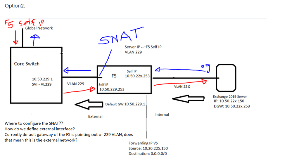

Also for option 2, I tried to configured the SNAT on the internal fowarding VS, where source is restricted to the server IP: 10.50.22x.150 but it didnt work. Is it better to configure global SNAT? Can you give some guidance for the option2? I've added some questions to the picture below:
