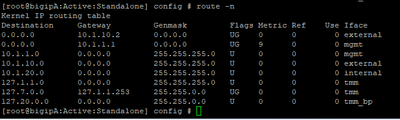

pool memeber: 10.1.20.12       self IP: 10.1.20.241 ( untagged 1.2 internal vlan- non-floting)

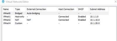

    So does VMnet4 have a gateway set?
    can your lamp server, see (ping) the gateway?
    can your big-ip, see (ping) the gateway?
    From one thing, its been a couple of years since i used workstation, but not sure what "custom" does.
    I would have said you wanted a Host-only network, or least test it with that first.
    My first guess is that this is a workstation / network interface issue.
    So also check your mac addresses under Network > Interfaces and make sure they align to your workstation config of the interfaces you have assigned.

    Vmnet4 doesn't configure any gateway. even i couldnt ping f5 self IP from the lamp server.

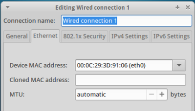

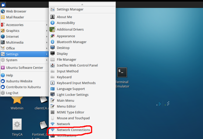

    Did you configure the interfaces in the Lamp? a simple test is make a ping from the lamp to the selfip configured in the same network in the bigip, if this doesn´t work probably your issue in the lamp network interface configuration, additional review that the F5 are in the same vnet than the lamp.

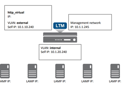

      Have you got 2 lamp servers on that network as per the diagram?
      Can those 2 LAMP servers see each other?

    i couldnt ping self ip from the LAMP server.
    i have configured interfaces in the lamp server but still getting failed.
