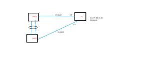

Aug 26, 2021F5 not support cable failover? or how can be configure
As mentioned in picture, If we connect F5 with two different switches using port 1.0 & 2.0. Both ports having same access vlan and they will be un-tagged with same vlan VLAN12. Now seems F5 not ...
Pawan_Goswami
Aug 26, 2021Thanks for your suggestion but in my environment, Switch are different platform at all and can't support link aggregation/fex extender like (Cisco VPC, Aruba, Cisco 650X VSS or Stacks switches..). Also I am looking cable failover scenarios not vlan failover.
I tried to put one interface on F5 as passive and another as forwarding. But seems i2600 F5 platform not supporting that feature enablement and it's look like F5 completely in-compatible with link failover.
