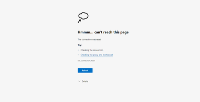

Also I am now seeing this image instead of "404 not found" when I involve the node with either an iRule or a policy.
