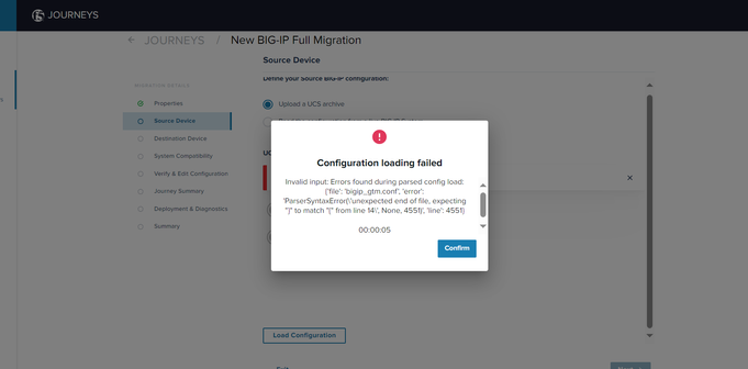

F5 JOURNEYS FAIL TO LOAD UCS WITH GTM CONFIG
I am trying to execute a BIG-IP Full Migration on F5 Journeys with a UCS file that has GTM module enabled, I am getting the following error
Invalid input: Errors found during parsed config load: {'file': 'bigip_gtm.conf', 'error': 'ParserSyntaxError(\'unexpected end of file, expecting "}" to match "{" from line 14\', None, 4551)', 'line': 4551}
00:00:05
I Have tried 2 separate ucs files from the BigIP and I am getting the same errors in Journeys.
Can anyone advise what the issue might be ?
Thanks in advance.
