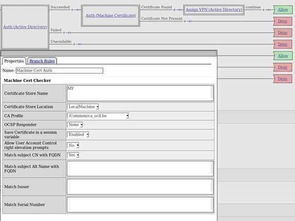

  • Good morning,
    Would you mind posting a snapshot of the APM VPE for your setup?

    A snapshot of the relevant APM VPE flow and the properties of the Machine Cert Auth check:
    The CA profile currently points to a certificate bundle consisting of our root CA and current intermediate CA. As stated in the opening post we would like to know if it's possible to add a new intermediate CA to this bundle to accomplish simultaneous verification of machine certs issued by our current intermediate CA and future machine certs issued by a new intermediate CA?
