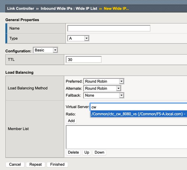

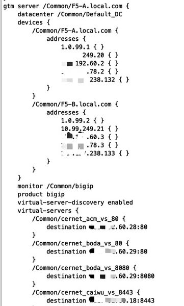

A new VS is added to the LTM module of the F5 LC, but the newly added VS cannot be automatically found in the link control module of the same F5 LC.
This cw VS was added three days ago,

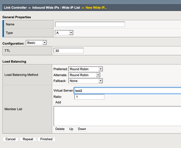

This test2 was added half an hour ago

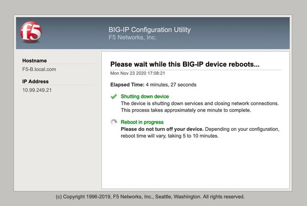

I found that ,the standby LC must be restarted before the vs can be discovered by active LC.😂

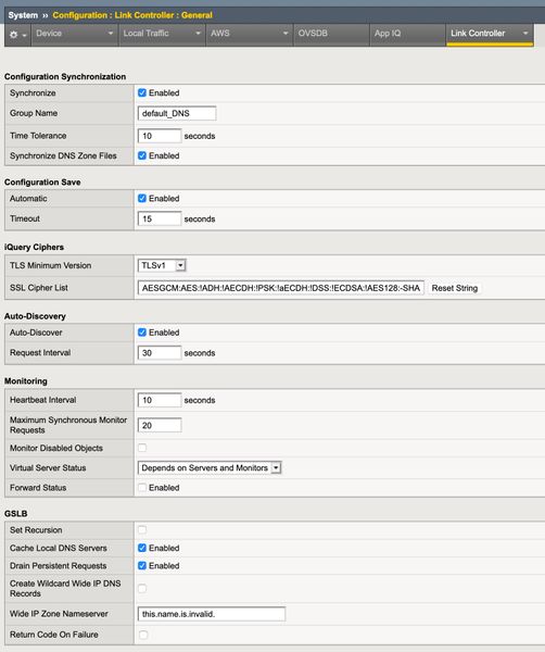

  • Not observed such issues in LC. Try to create vs again and see the results. If again same issue then check with TAC.
    I am suspecting issue with LC settings.​
