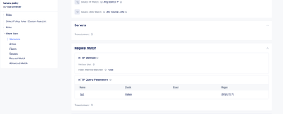

I tested this on other vendors and it is the same as the info I got is that there are no default signatures for this RFI attack as it will cause many issues an false positives, so you need to make a custom signature/irule to block this for the specific vunrable parameter.
Outside of that for XC Distributed Cloud the Service policy rules seem the way to go for configuring something like signatures:

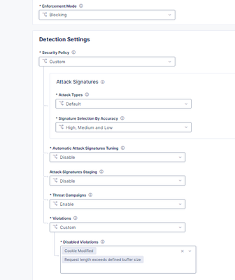

Yes, maybe I am doing the test wrong, still another big issue is that Nginx App Protect also has the option for custom signatures (Configuration | NGINX Ingress Controller) but for now XC Distributed cloud does not and even with all signatures enabled and not in staging the RFI attack is not blocked on XC.
As a test backend with metasploitable 3 you can exploit this vunrability as seen in your picture with the query "page" parameter.
