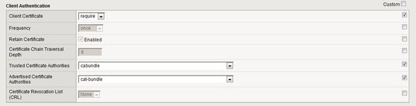

We are using the below option and now bundled with our internal ca. the problem here this will allow all users who has the certificate from the same CA, so i am trying to limit this

Limit how?

Ah, I see. Well, as Josiah answered in your other post (https://devcentral.f5.com/questions/client-authentication-user-authentication-certificates?, once consumed the BIG-IP will have access to all of the X509 data from the certificate. The CA bundle provides a trust mechanism to complete the SSL handshake. You then need to provide a mechanism to validate the contents of the certificate. Take a look at the X509 section in the wiki for some ideas on how to handle this in iRules.
https://devcentral.f5.com/wiki/iRules.X509.ashx
