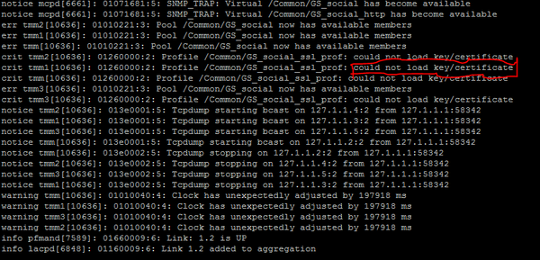

I found error certificate below picture. How I solve it.

I seen this on 11.5.1 hf5 after load ucs v. 10 into this box for replacement
Did error make client certificate error or any problems?
We can't switch to new box because of this error
Thank you

I try re-add certificate/key into new ssl profile but error seem still occur.
Tmsh load sys config is fine though

What I'd recommend trying is removing the certificate and private key from F5 box entirely (incl. links to SSL profiles and raw files). Start from a fresh import.
After certificate deletion, CD to directories "/config/filestore/files_d/Common_d/certificate_d" and "/config/filestore/files_d/Common_d/certificate_key_d" - verify there are no left-over files of your certificate or private key. (directories are for F5 v11.x)
