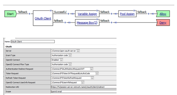

    This is the doc I followed : https://support.f5.com/csp/article/K14391041 ; But I changed some settings, for example my client want to use OpenID Connect with it. On apptest.example.com there is just one Access Profile (Per-Session Policy). Like this :
    When the user connects for the first time and pass it through, it works, but when he has an active session he can't connect to apptest.example.com, I have an error "Secure Connection Failed" ... An error occured during a connection to apptest.example.com. PR_CONNECT_RESET_ERROR

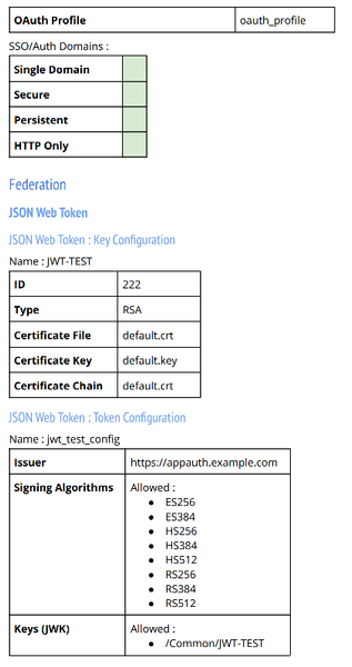

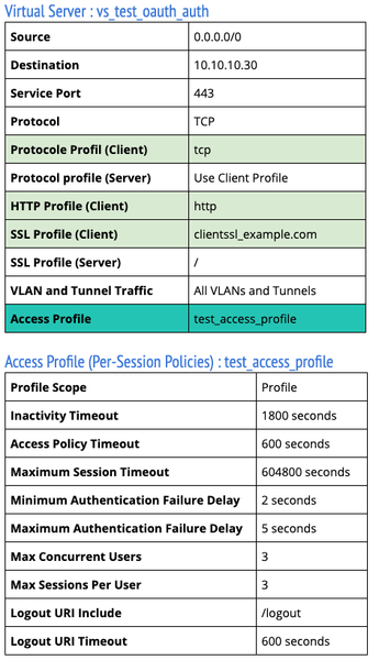

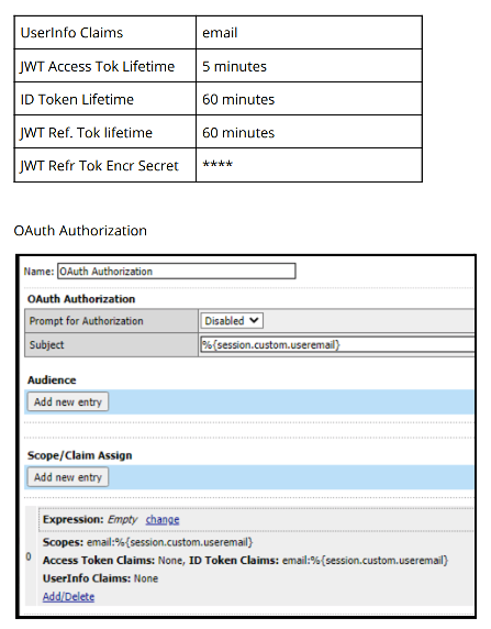

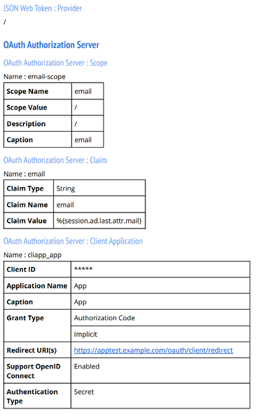

  • Here is the doc I made, the first one is the Internal WAF, this F5 will act as the Authorization Server :

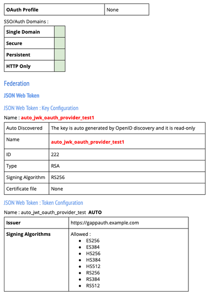

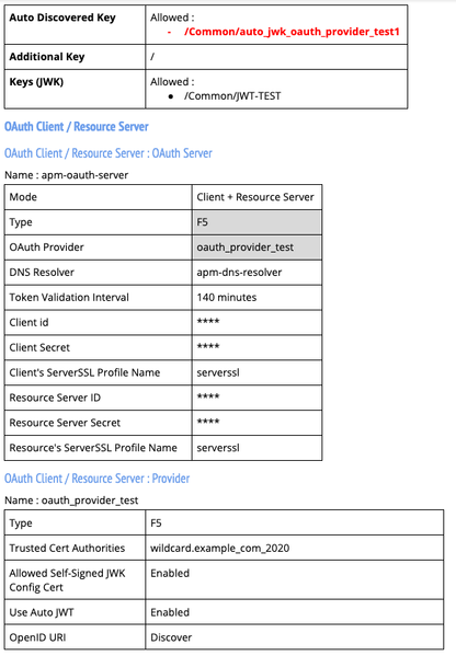

  • And here the doc about the second F5, acting as the Client.
