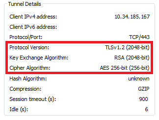

David_G__33241
May 26, 2015My question is about connecting with the Edge Client.
The DEFAULT Cipher Suite supports TLS only. If I disable TLS 1.0, 1.1 and 1.2 in Windows I am unable to establish a connection to the Big-ip using the Edge client - this would imply that the Edge client leverages the Windows security configuration. However, if I enable TLS 1.0 in Windows, then the Edge client DOES connect and it reports the protocol as being TLS 1.2 - this would imply that the cipher suite is built-in the Edge client.
I'm trying to understand the mechanics of this...
