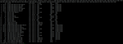

Many thanks for helping me out. I've ran this string on F5.
tmm --clientciphers 'DHE-RSA-AES256-SHA:DHE-RSA-AES128-SHA:EDH-RSA-DES-CBC3-SHA:DHE-RSA-AES256-SHA:DHE-RSA-AES128-SHA:EDH-RSA-DES-CBC3-SHA:DHE-RSA-AES256-GCM-SHA384:DHE-RSA-AES128-GCM-SHA256:DHE-RSA-AES256-SHA256:DHE-RSA-AES128-SHA256:DHE-RSA-AES256-SHA:DHE-RSA-AES128-SHA:EDH-RSA-DES-CBC3-SHA'

I've seen you're running DEFAULT , so I'll keep that as a starting point. First exclude TLS1 and TLS1.1 with "DEFAULT:!TLS1:!TLS1_1" and run tmm --clientciphers "<string>" to see if there's still some suites that must be removed, it's likely that the weak TLS1.2 suites you mentioned will still be in the list, for example DHE-RSA-AES256-GCM-SHA384
You need to exclude all of the unnecessary suites manually, so string will become "DEFAULT:!TLS1:!TLS1_1:!DHE-RSA-AES256-GCM-SHA384:!<...>:!<...>:!<...>"
When you're done, run again tmm --clientciphers <string> to see the list of the remaining allowed suites.

tmm --clientciphers 'DEFAULT:!TLSv1:!TLSv1_1:!DHE-RSA-AES256-SHA:!DHE-RSA-AES128-SHA:!EDH-RSA-DES-CBC3-SHA:!DHE-RSA-AES256-SHA:!DHE-RSA-AES128-SHA:!EDH-RSA-DES-CBC3-SHA:!DHE-RSA-AES256-GCM-SHA384:!DHE-RSA-AES128-GCM-SHA256:!DHE-RSA-AES256-SHA256:!DHE-RSA-AES128-SHA256:!DHE-RSA-AES256-SHA:!DHE-RSA-AES128-SHA:!EDH-RSA-DES-CBC3-SHA'- Sri_Narasimha_11Apr 15, 2023
