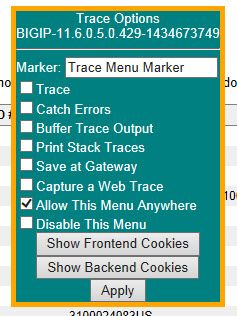

We use an Access Portal within APM to allow external access to internally hosted applications. I just want to disable the disable the Trace Options menu from when you right click within the Access Portal. We just want it have the standard expected result from a right click on a webpage at all times and on a global basis.
Here is what we get currently if you right click over whitespace:

This trace menu is enabled when Debug Log Mode is enabled for Rewrite / Portal Access. Simply change the logging level from debug to anything else and it'll go away.
Perfect, thanks so much.
went to System -> Logs -> Configuration -> Options Then Access Policy Logging and changed Portal Access from "Debug".
