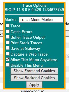

Dec 10, 2015Disable Trace Options within APM Access Portal.
Hello all,
I have done multiple searches looking for a solution to this, thinking it would be a simple button to uncheck somewhere. However I've been unsuccessful on google and devcentral. ...

This trace menu is enabled when Debug Log Mode is enabled for Rewrite / Portal Access. Simply change the logging level from debug to anything else and it'll go away.

Dec 10, 2015Perfect, thanks so much.
went to System -> Logs -> Configuration -> Options Then Access Policy Logging and changed Portal Access from "Debug".
The exact answer I needed.
