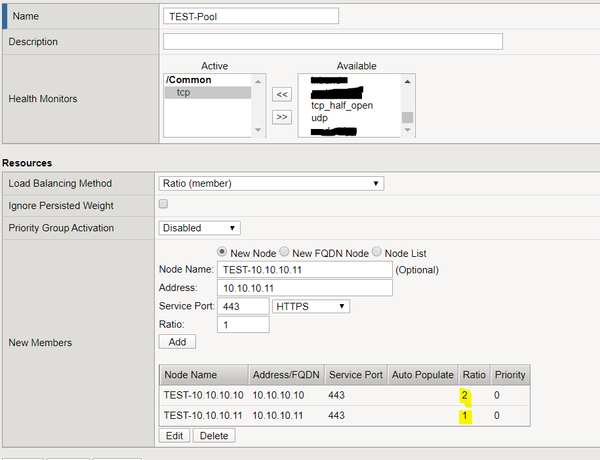

    Ratio (Member) – In this type, you assign ratio weight to each pool member according to capacity of server. The number of requests that each server receives over time will be directly proportional to assigned ratio. This type of configuration will be applicable to specific pool.

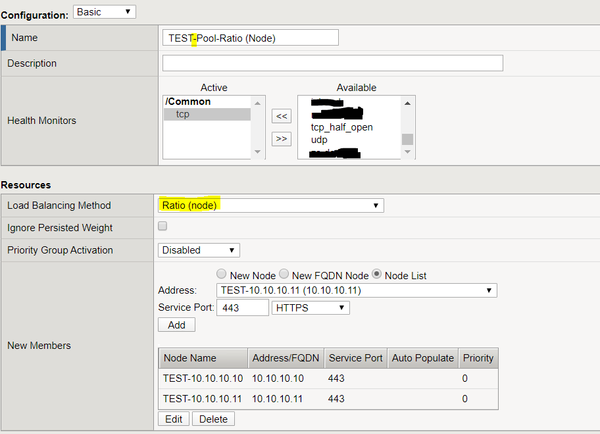

    Ratio (Node) – In this type, you assign ratio to each node. So number of request that each node receives will be directly proportional to the assigned ratio to the node. When you configure ratio on node, that ratio will be applicable for all the pools where such node is added. In other words, wherever (any pool) you will add such node, the assigned ratio will be applicable to all such pools.
    Major difference between both of above types is 1st type will be applicable to only that specific pool as you’re defining ratio under pool. And in 2nd, it will be applicable to all such pool where that particular node is available as you’re defining ratio under node itself.

    1. Ratio (Member) -Here you simply define ratio to each member under pool. And this ratio will be specific to this pool only.

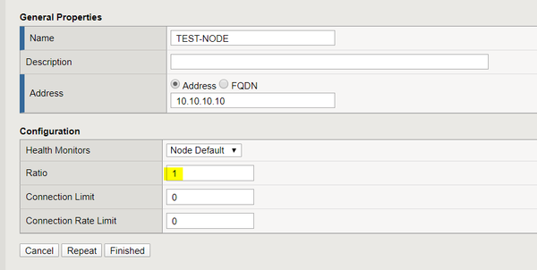

    2. Ratio (Node) - Here while creating node, you need to define ratio to the node. Default assigned value is 1.
    Once you define ratio to the node. You can call those node under pool. If under pool, Ratio (Node) algorithm is configured, then F5 will distribute requests according to weight configured on node level.
